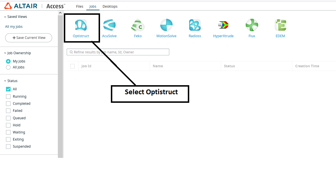

How to submit Optistruct job by using Standard Application Definition
How to submit Optistruct job by using Standard Application Definition deployed Appliances.

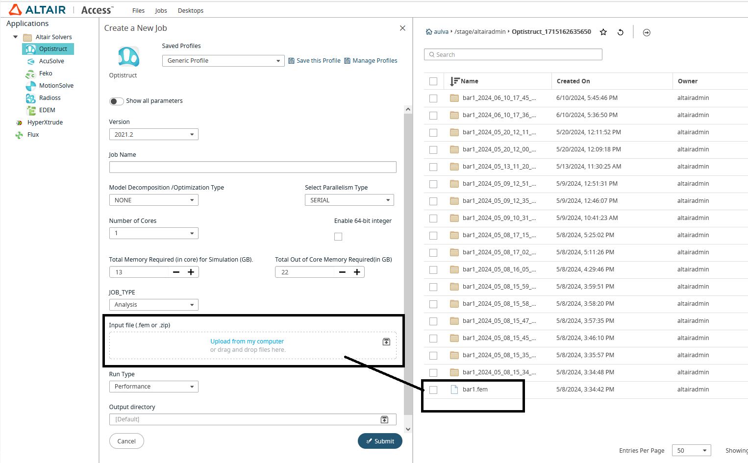

Drag and Drop primary input file to run the job/workload ,

Input file
Primary input file for the job. Note: space and characters are not valid input filename. The input file can be .fem or .zip(Where the .fem file should be present inside the .zip file)

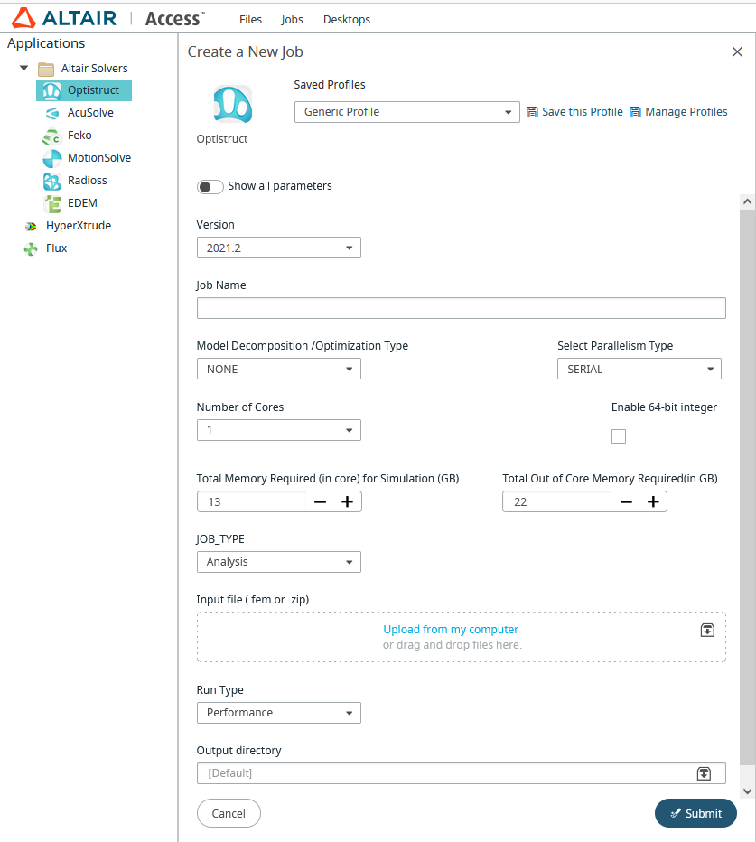

            Following are the form fields can be modified as per job requirements.

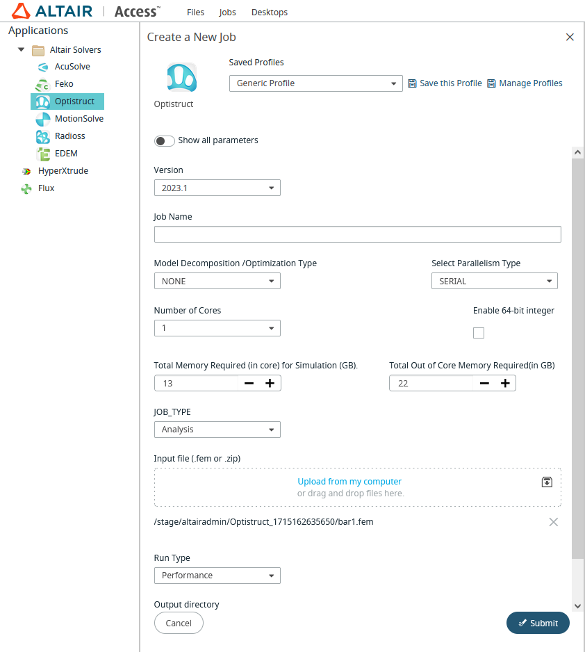

            Following image showing the form loaded after selecting Application definition:
A screenshot of a computerDescription automatically generated
Field Name
Default
Version
Select the version of the application to use.
Configurable / Usually latest version
Job Name
Name of the job
Note: Special characters and spaces are not allowed in job name.
Input file name without extension
Model Decomposition / Optimization Type
Select the model decomposition method / optimization type.
[NONE, LDM, DDM, MMO, FSO]
NONE
Select Parallelism Type
Select the parallelism Type:
1. SERIAL: Allows the job to be run with single core/CPU.
2. SMP: Allows the job to be run with CPUs available within one node in a cluster. Uses Threads.
3. MPI: Allows the job to be run with CPUs available across multiple nodes. Uses MPI Processes.
4. HYBRID: Allows the job to use a combination of MPI processes and threads. Generally faster and uses an optimal memory foot print.
SERIAL
Number of Cores
Select the total number of CPUs/cores to be used.
1
Enable 64 bit integer
Use executable compiled with 64-bit integer. Generally useful for larger models. Expect the job to be slower when compared with the option disabled.
False
Total Memory Required (in core) for Simulation (GB)
Select the total memory required for the simulation in GB. This information is generally available in the simulation output files. Selecting a value closer to the real memory need will increase the chance of the simulation to complete successfully.
Note: This is NOT the same as memory per core.
User editable with reasonable default value based on the selected number of cores.
Total Out of Core Memory Required (in GB)
Select the total out core memory required (local scratch disk space) for the simulation in GB. This information is generally available in the simulation output files. Selecting a value closer to the real out core memory need will increase the chance of the simulation to complete successfully.
JOB_TYPE
Select Job Type (Analysis / Optimization)
Analysis
Input file (.fem or .zip)
Select the input file to be used with the simulation. You can directly input the .fem file or else you can input the file with extension .zip where the .fem file present.
Note: Special characters and spaces are not allowed in file name.
Run Type
Selecting Performance mode will ensure that your job runs on an exclusive set of nodes and should expect your jobs to finish faster. On a busy cluster, this may lead to higher wait times.
Selecting Throughput mode will cause the scheduler to find the required resources even if they are scattered across several nodes in the cluster. This may increase the possibility of your job starting sooner than in the Performance mode. Your simulations may run longer than usual.
Default: Throughput
Output directory
Specify the directory where the result files will be stored after the job is complete.
User editable reasonable default : /stage/username/jobname_timestamp

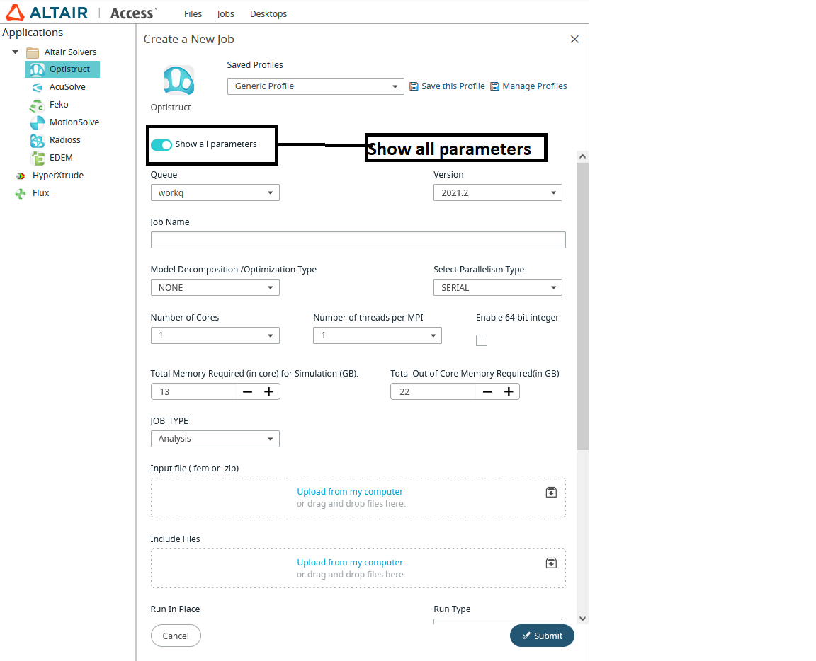

Apart from default Additional form fields are visible here, Following are the additional form fields other than default form fields:
Field Name
Default
Queue
Select the queue to which the job must be submitted.
Number of threads per MPI
Will use the thread count selected per MPI process; A total of " + <above selected cores> + " CPU cores selected will not be exceeded. Use more threads to minimize Memory footprint.
User editable reasonable default : 1
Run In Place
Check this box if you want to run your job in the same directory where your input file is. This will prevent the expensive file copies. May impact performance of the simulation.
User selectable reasonable default: False
Include Files
Select the include files to be used with the simulation. Generally, the include files are auto selected/added. But this is only an assist feature. Please ensure all the necessary include files are added and available before submitting the job.
Schedule After
Select this option to schedule your job to run at specific time in future. Note that the job becomes eligible to run after the selected time. Actual start times may differ based on the resources available on the cluster.
Kill Job After
Specify the estimated time that your job is expected to run on the cluster. Providing a good estimate increases the chances of your job starting sooner.
Note: The scheduler will kill the job if the actual wall time exceeds the estimated time specified.
Dependency type
Specify the Dependency Type:
afterok: start the current job only if the specified depend job is successful.
aferany: start the current job after the specified depend job irrespective of exit status.
Default: afterok
Dependent on Job
Specify the job id of a previously submitted job after which the current submission is expected to run.
Additional Options
Specify any valid command line options that you need to pass to the application. The options will be passed verbatim to the application.
