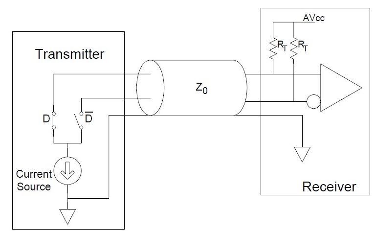

- Electric specifications
- One TMDS differential pair: Current driver at Transmitter (Tx), Pull up resistor at Receiver (Rx)
Fig. 2. Conceptual schematic for one TMDS differential pair.
