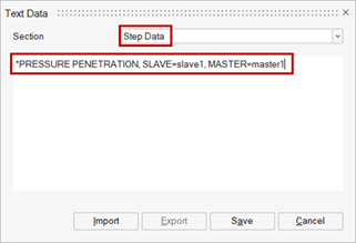

For “*PRESSURE PENETRATION” card support:
- Currently, SimLab does not support the pressure penetration loading for the surface-based contact. As a workaround, kindly include the above card as text input as shown below.
