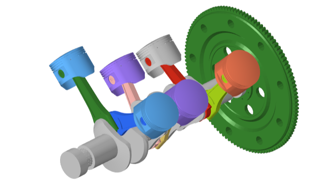

- Import IC engine geometry into MotionView.
Figure 1: IC Engine Geometry

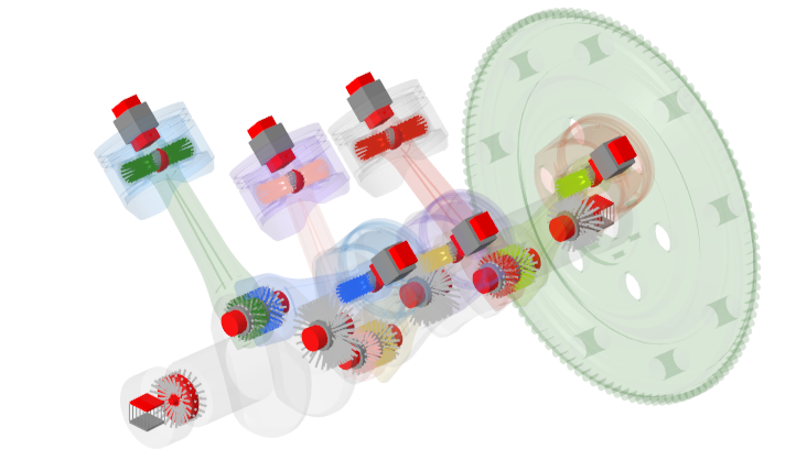

- Create points and joints to connect the bodies.
Figure 2: View of the Joints Connecting Each Body
- Create forces to represent the gas forces, the electric motor torque, the resisting torques from auxiliaries, and a torsional damper to represent external resistance.

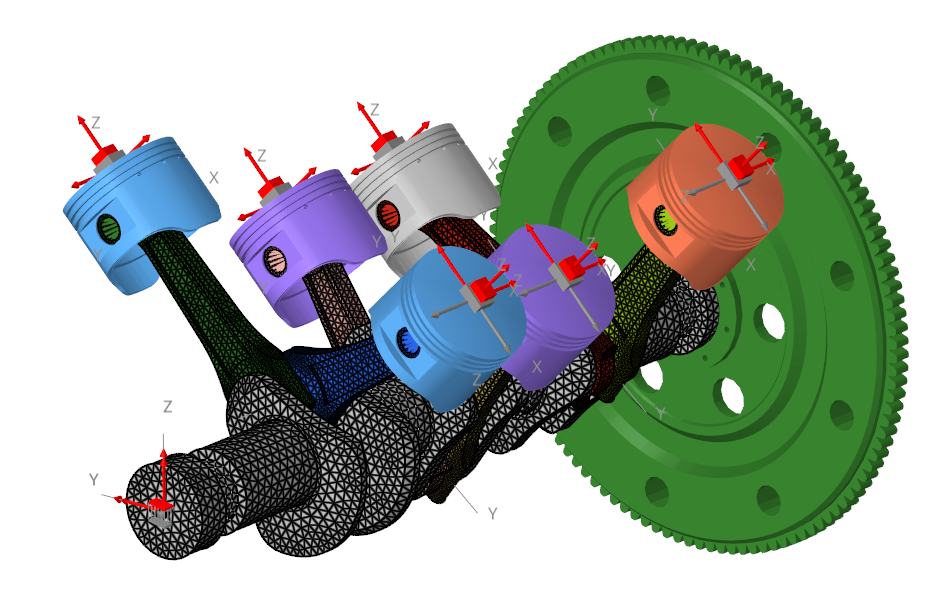

- Use FlexPrep to create flexible bodies for the crankshaft and connecting rods.
- Change the crankshaft and connecting rod bodies to flexible and select the .h3d files created with FlexPrep.
Figure 3: IC Engine MBD Model with Flexible Crankshaft and Con Rods

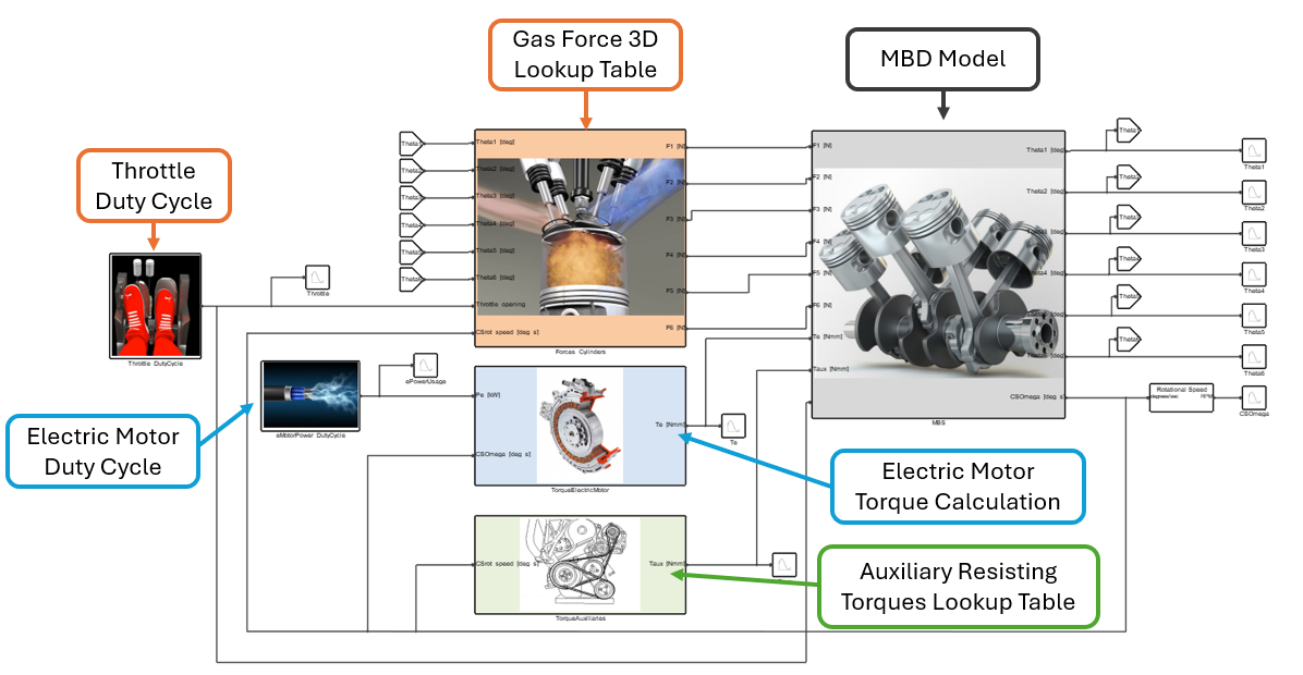

Twin Activate is a 1D modeling tool specializing in controls systems and physics. Twin Activate will handle the calculations for gas forces in the IC engine, electric motor torque, and auxiliary torques.
Figure 4: Twin Activate Model
Internal Combustion Engine: A 3D lookup table takes in the throttle opening, crankshaft velocity, and phase of the cycle to find the pressure on the piston. The pressure is used to calculate force, which is sent to the MBD model.
Electric Motor: The electric motor duty cycle is defined as the power produced by the electric motor. The power from the motor and velocity of the crankshaft are used to calculate the contribution of torque from the electric motor.
Auxiliaries: A lookup table is used to find the resisting torques created by the auxiliaries based on the speed of the crankshaft.
The gas forces and torques are sent to the multibody dynamics model. The MBD solver uses the boundary conditions to calculate the forces and kinematics of all modeled engine components. Crankshaft phase and velocity are sent back to the Twin Activate model for the next timestep.

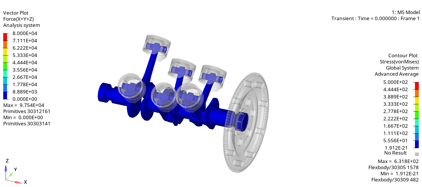

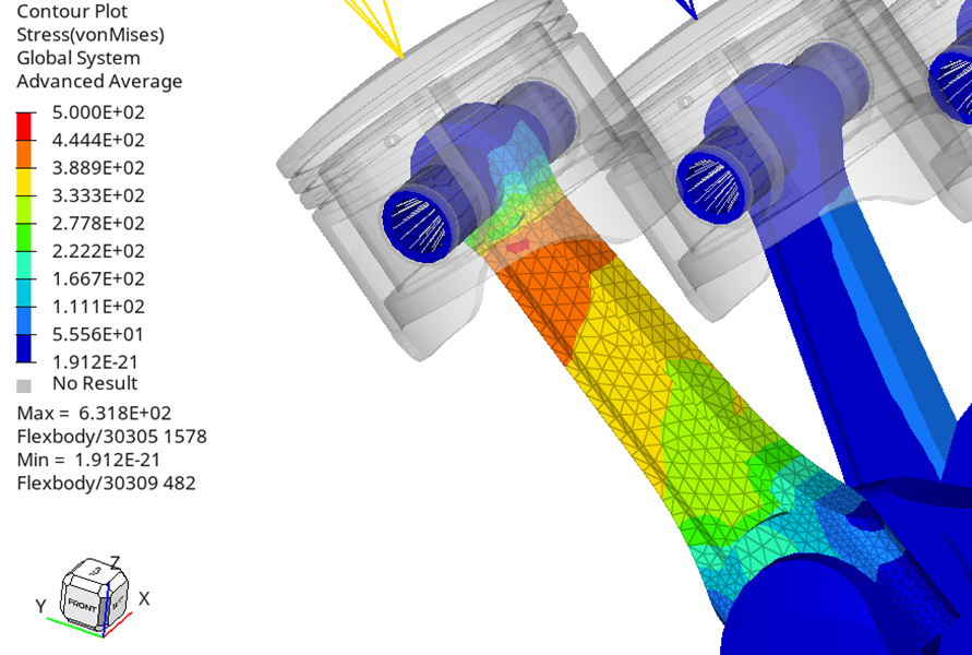

After finishing the simulation, the forces on each body can be animated. Figure 6 shows the stresses experienced by the crankshaft and connecting rods. Hotspots like those shown in Figure 7 can be used to inform fatigue analysis.
Figure 5: Engine Motion and Gas Forces
Figure 6: Crankshaft & Connecting Rod Stresses with Piston Forces Displayed
Figure 7: Connecting Rod Hotspots for Fatigue Analysis

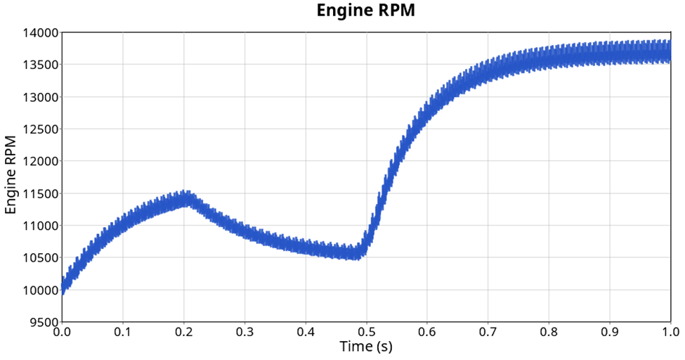

Engine performance metrics like power, torque, velocity, and more can be plotted in HyperGraph.

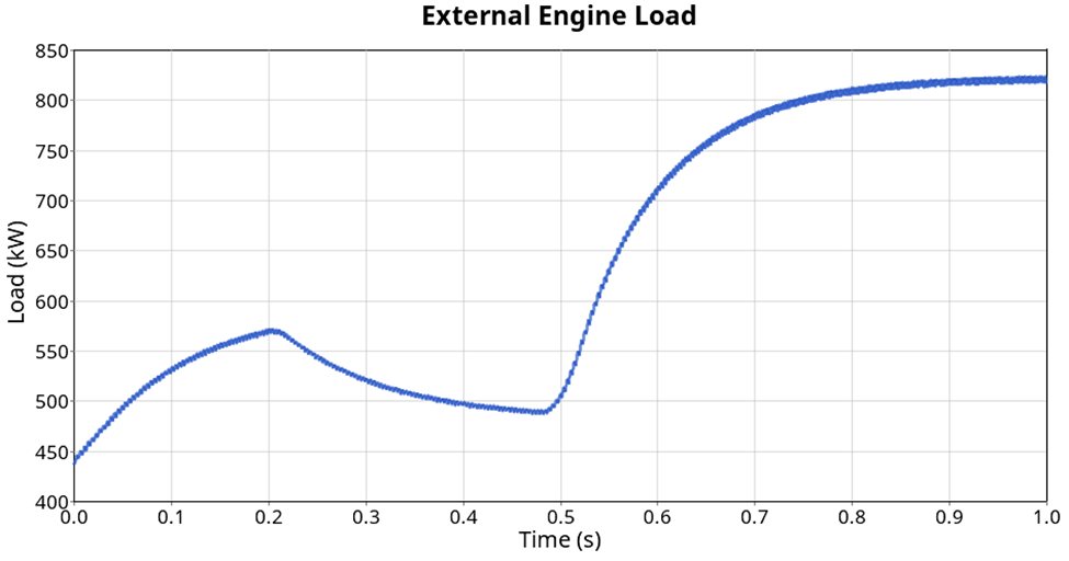

Figure 8: External Engine Load
Figure 9: Engine RPM

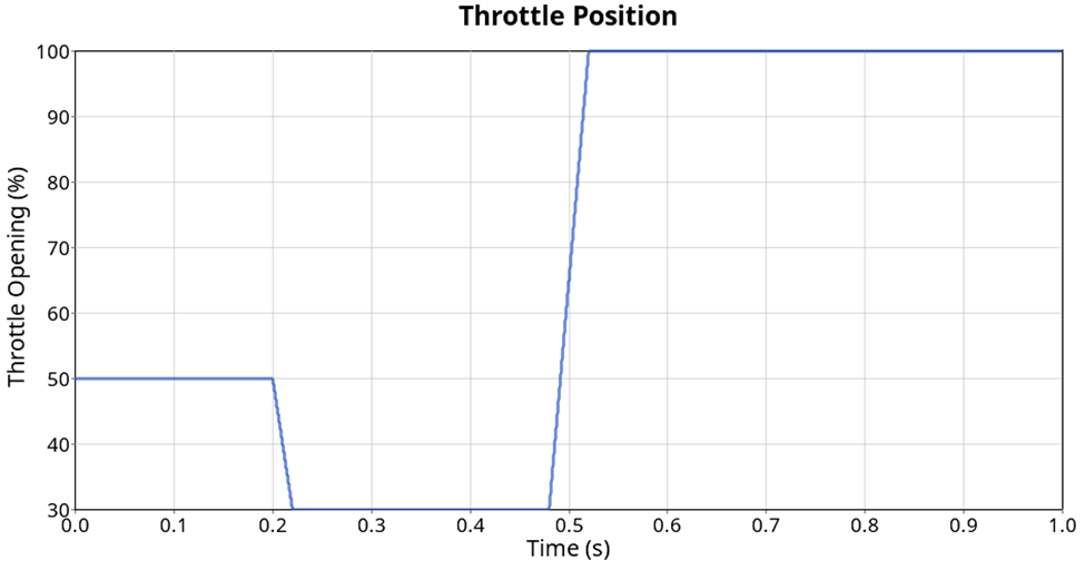

Figure 10: Throttle Position

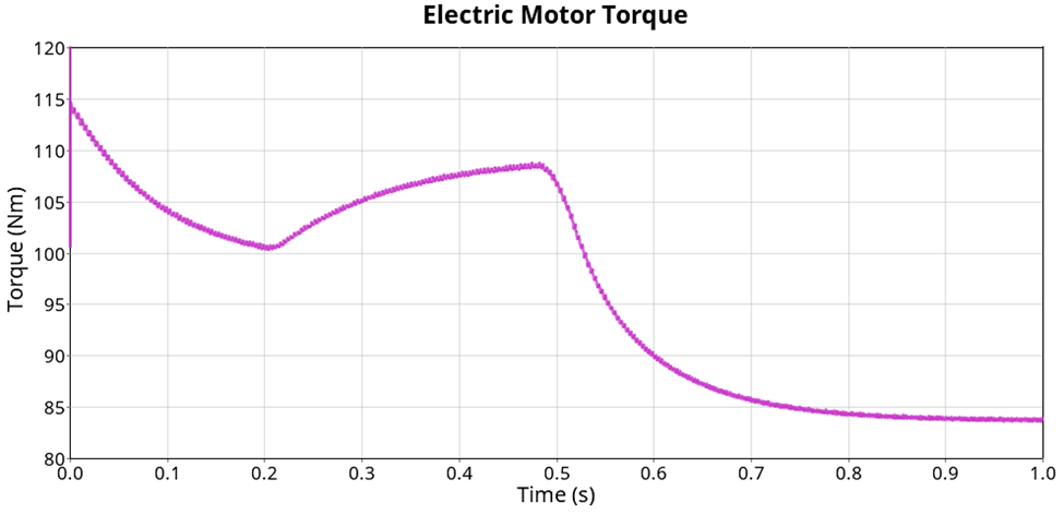

Figure 11: Electric Motor Torque

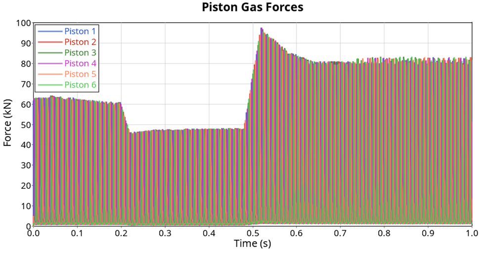

Figure 12: Piston Forces

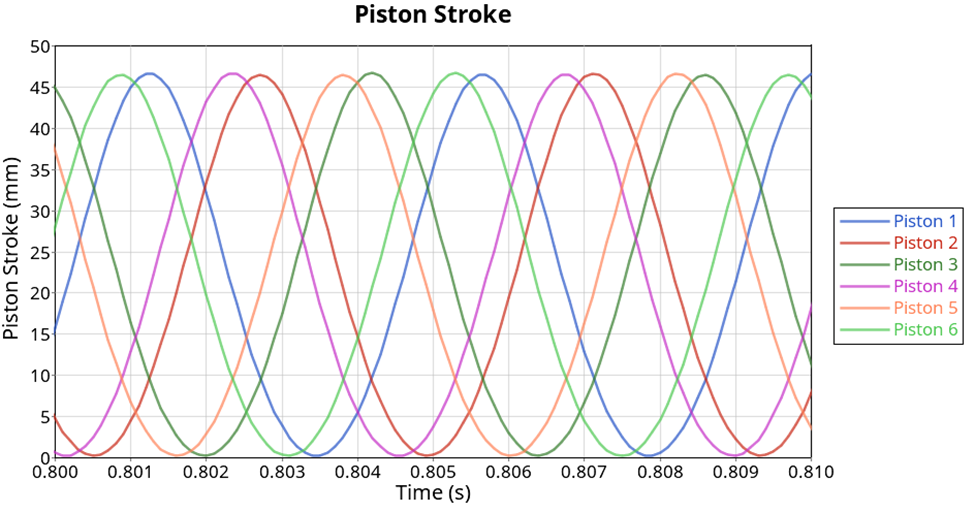

Figure 13: Piston Stoke from 0.80 to 0.82 Seconds

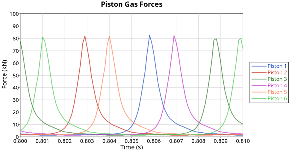

Figure 14: Piston Forces from 0.80 Seconds to 0.82 Seconds.

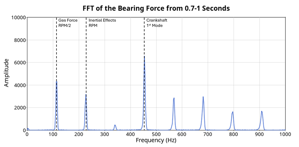

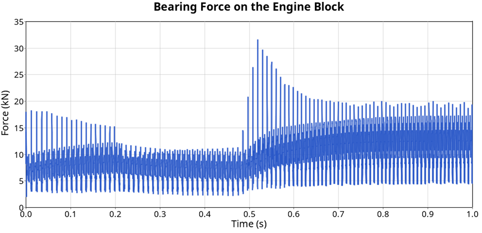

Forces on the engine block can be measured in the multibody dynamics model. The force of one of the main bearings is shown in Figure 15. The frequencies the crankshaft and engine block will vibrate at can be found by processing the data and taking a Fast Fourier Transform. The FFT results are shown in Figure 16.
Figure 15: Bearing Force on the Engine Block
Figure 16: FFT of the Bearing Force
